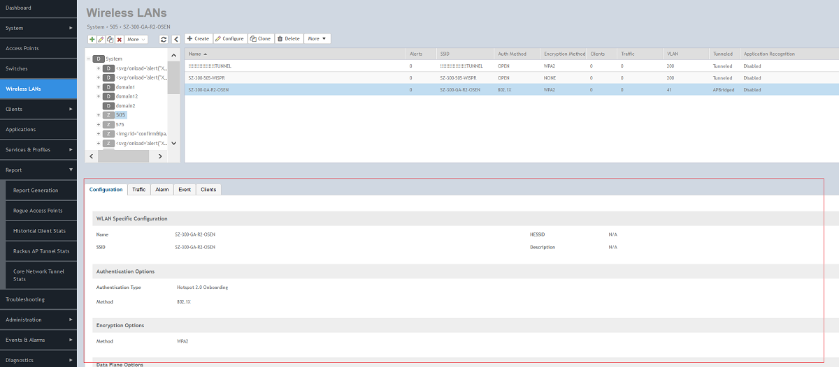

    The zone configuration information is displayed.
    Figure 264  Monitoring Zone Configuration
