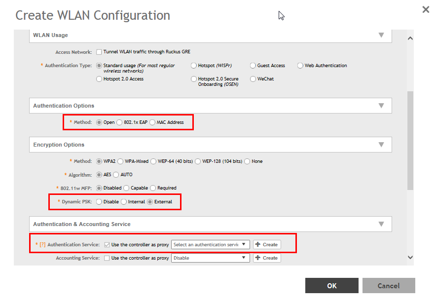

  4. Create a WLAN Configuration for DPSK. Refer, Creating a WLAN Configuration.
    Figure 127  External DPSK Configuration
