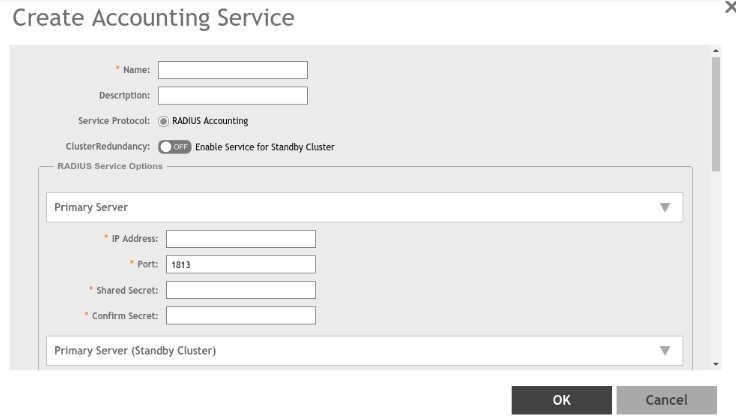

    Figure 178  Creating an Accounting Service
  4. Configure the following:
    1. Name: Type a name for the authentication service that you are adding.
    2. Description: Type a description for the authentication service.
    3. Service Protocol: By default, the RADIUS Accounting selected. For more information, see RADIUS Service Options.
    4. Cluster Redundancy: Click the Enable Service for Standby Cluster option to enable cluster redundancy.
  5. Click OK.
You have completed creating a Proxy Accounting AAA server.
