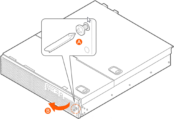

  1. Loosen the captive bezel retention screw on the right side of the bezel (see A in Figure 194).
  2. Rotate the bezel to the left to free it from the pins on the front panel (see B in Figure 194), and then remove it.
    Figure 194  Removing the front bezel
