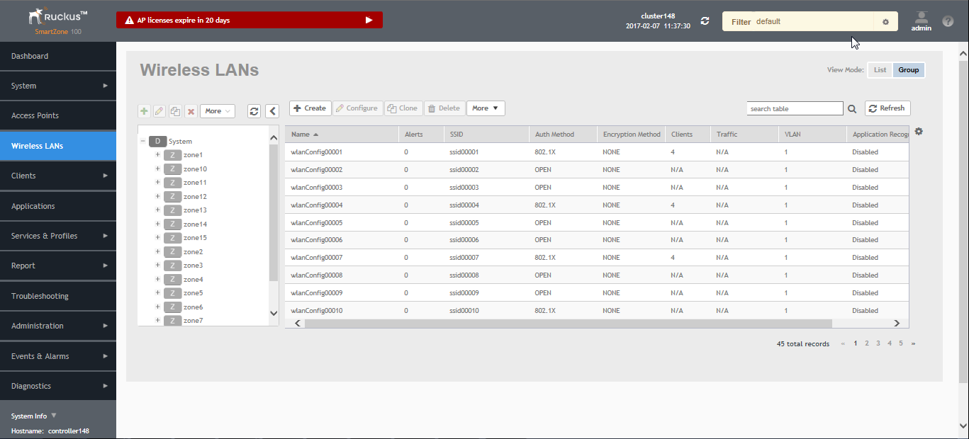

Creating a WLAN Configuration
To create a WLAN configuration:

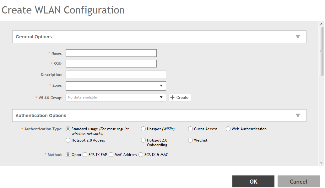

| Field | Description | Your Action |
| General Options | ||
| Name | Indicates the user-friendly administrative name for the WLAN. | Enter a name. |
| SSID | Indicates the SSID for the WLAN. | Enter the SSID |
| Description | Indicates a user-friendly description of the WLAN’s settings or function. | Enter a short description. |
| Zone | Indicates the zone to which the WLAN configuration will applies. | Select the zone to which the WLAN settings apply. |
| WLAN Groups | Indicates the WLAN group(s) to which the WLAN applies. | Select the WLAN groups to which the WLAN configuration applies.. |
