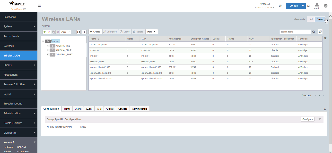

To create a WLAN configuration:
- In the Wireless LANs page, from the
		  System tree hierarchy, select the
		  Zone where you want to create a WLAN.
		  Figure 84 Wireless LANs

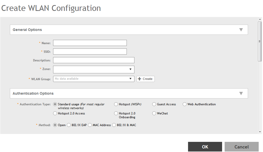

- Click
		  Create,
		  Figure 85 appears.
		  Figure 85 Create WLAN Configuration
- Set the required configurations as explained in the below table.
- Click OK.
