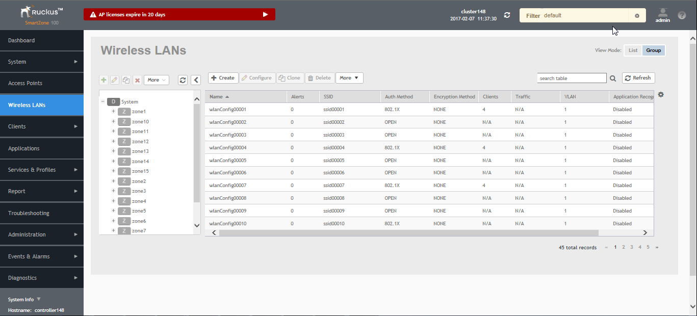

To create a WLAN configuration:
  1. In the Wireless LANs page, from the System tree hierarchy, select the Zone where you want to create a WLAN.
    Figure 80  Wireless LANs

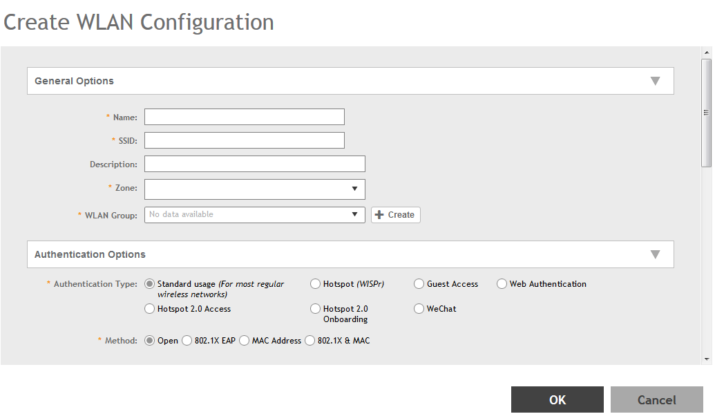

  2. Click Create, Figure 81 appears.
    Figure 81  Create WLAN Configuration
  3. Set the required configurations as explained in the below table.
  4. Click OK.
Table 18 WLAN Configurations
Field Description Your Action
General Options
Name Indicates the user-friendly administrative name for the WLAN. Enter a name.
SSID Indicates the SSID for the WLAN. Enter the SSID
Description Indicates a user-friendly description of the WLAN’s settings or function. Enter a short description.
Zone Indicates the zone to which the WLAN belongs. Select the Zone to which the WLAN settings apply.
WLAN Groups Indicates the WLAN group(s) to which the WLAN applies. Select the WLAN Groups.
Authentication Options
Authentication Type Defines the type of authentication flow for the WLAN.
Authentication types such as WeChat, Web Authentication and Guest Access are not supported by APs in IPv6 mode.
Select the required option:
