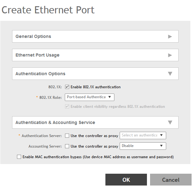

Creating an Ethernet Port Profile
An Ethernet port profile contains settings that define how an AP will handle VLAN packets when its port is designated as either trunk, access, or general port. By default, three Ethernet port profiles exist: General Port, Access Port and Trunk Port.
  1. Go to Services & Profiles > Tunnels and Ports.
  2. Select the Ethernet Port tab, and then select the zone for which you want to create the profile.
  3. Click Create.
    The Create Ethernet Port page appears.
    Figure 190  Creating a Ethernet Port Profile
  4. Configure the following:
    1. General Options
      1. Name: Type a name for the Ethernet port profile that you are creating.
      2. Description: Type a short description about the profile.
      3. Type: The Ethernet port type defines how the AP will manage VLAN frames. You can set Ethernet ports on an AP to one of the following types: Trunk Port, Access Port or General Port.
        By selecting the appropriate port type, authentication method, and 802.1X Role, administrator can configure the ethernet ports to be used for the wired client. Up to 16 devices can be configured to connect to one ethernet port. After configuring the ports, the wired clients and their stats are displayed in the Clients > Wired Clients page. You can also delete a wired client from this page.

    5. Authentication Options
      1. 802.1X: Select this check box to enable 802.1X authentication.
      2. Enable client visibility regardless of 802.1X authentication: select this check box to bypass 802.1X authentication for client visibility.
        You can view statistical information about wired clients even without enabling 802.1X authentication.
      3. 802.1X Role: Select the authenticator role from the drop-down menu. Options include Supplicant, MAC-based Authenticator and Port-based Authenticator. When you select Supplicant, you can customize the username and password to authenticate as a supplicant role or use the credentials of the AP MAC address. When you select Port-based Authenticator, only a single MAC host must be authenticated for all hosts to be granted access to the network. If you select MAC-based Authenticator, each MAC address host is individually authenticated. Each newly-learned MAC address triggers an EAPOL request-identify frame.
    6. Authentication and Accounting Services
      1. Authentication Server: Select the check-box and a controller from the drop-down menu to use the controller as a proxy authentication server.
      2. Accounting Server: Select the check-box and a controller from the drop-down menu to use the controller as a proxy accounting server.
      3. Enable MAC authentication bypass: Select this check-box if you want to use the device MAC address as access credentials (username and password).
    7. RADIUS Options
      1. NAS ID: Set the NAS ID for the AP to communicate with the RADIUS server. Options include using the AP MAC address or any User-defined address.
      2. Delimiter: If AP MAC is selected to configure the NAS ID, then you can choose between Dash or Colon as delimiters to separate.
    8. Click OK.
You have created the Ethernet Port profile.
