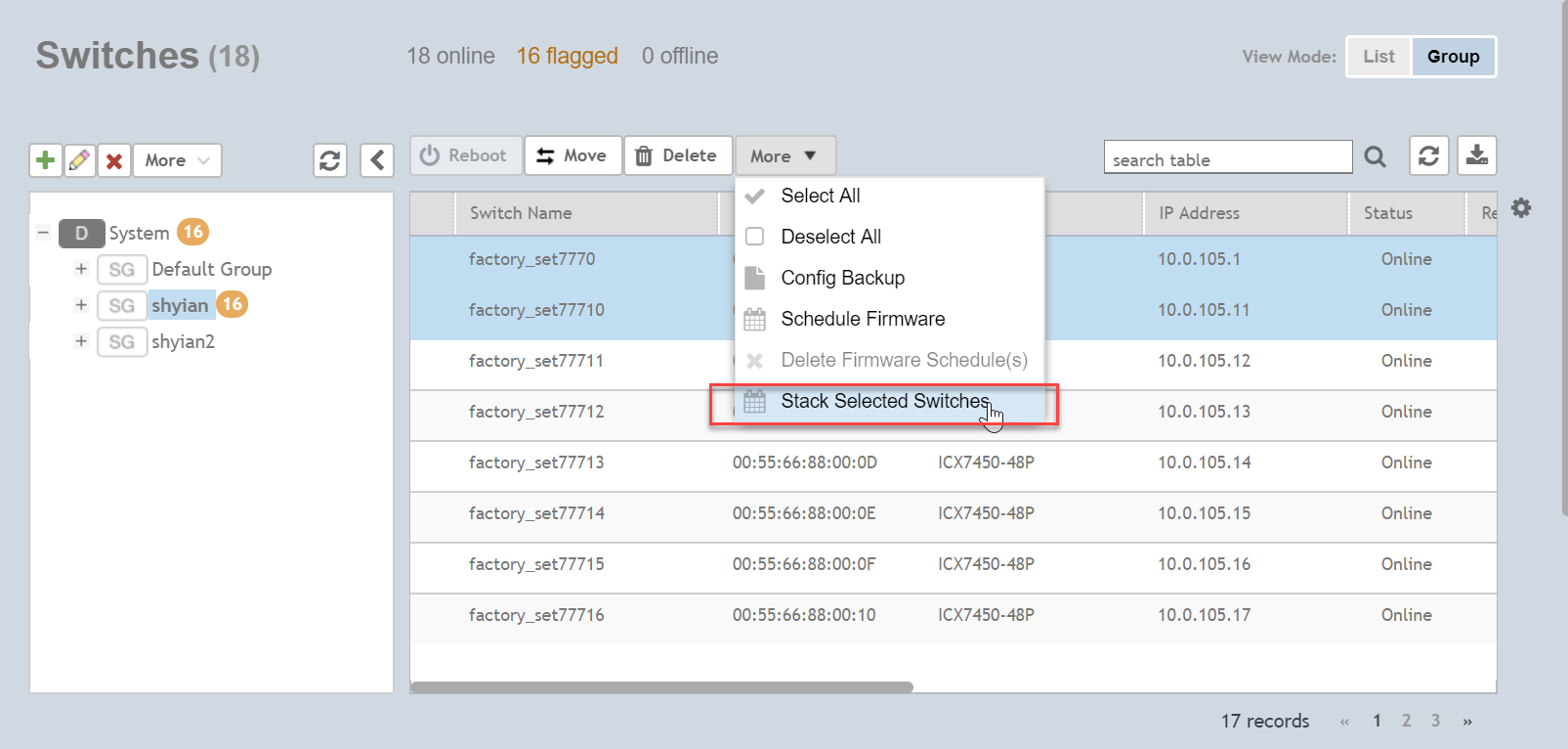

  1. From the left pane, click Switches and then select the switch group.
    Figure 89  Switches Page
  2. Select the switches that has to be stacked and click More > Stack Selected Switches. The Create Stack page is displayed.

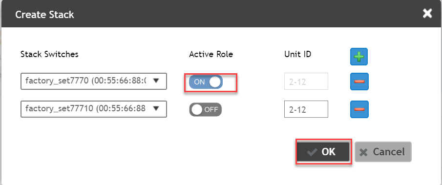

    Figure 90  Creating a Stack
  3. Under Active Role, select ON for the selected switches and click OK to create the stack.
The created switch stack is reflected in the Switches page within a switch group.
