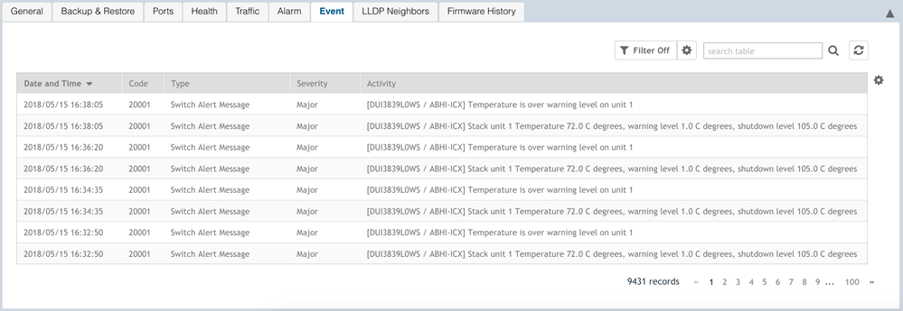

  2. Select the switch or group. Then select the Events tab.
    Figure 100  ICX Events Tab
    The following information is displayed in the Events tab:
    • Date and Time: Displays the date and time when the event occurred
    • Code: Displays the event code (see the Alarm and Event Reference Guide for your controller platform more information)
    • Type: Displays the type of event that occurred (for example, Switch configuration updated)
    • Severity: Displays the severity level assigned to the events such as Critical, Debug, Informational, Warning, Major etc .
    • Activity: Displays additional details about the event
    Click to export the events details to a CSV file. Check the default download folder of your web browser and look for a file named events.csv and view it using a spreadsheet application
    You can also view alarms by their severity, date and time. Click to apply filters.
