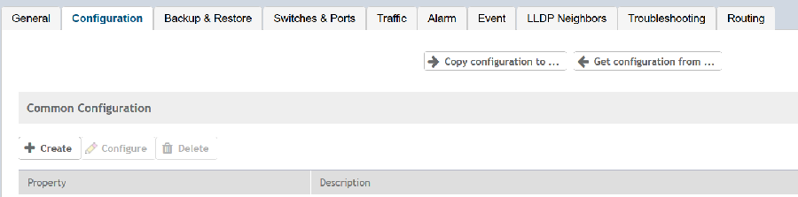

  2. Select the switch and then the Configuration tab.
    Figure 82  ICX Switch Group Configuration Tab
  3. Click Copy Configuration To.
  4. Select the switch group and click OK.

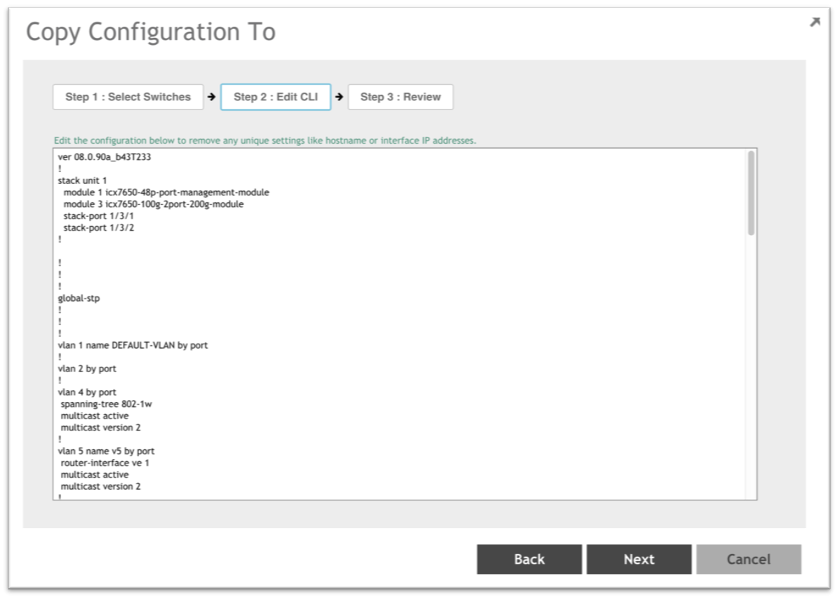

  5. Edit the CLI commands to remove unique settings like IP settings and hostname and click Next.
    Figure 83  Copy Configuration To - Edit CLI Page
  6. Review CLI config and click OK.
