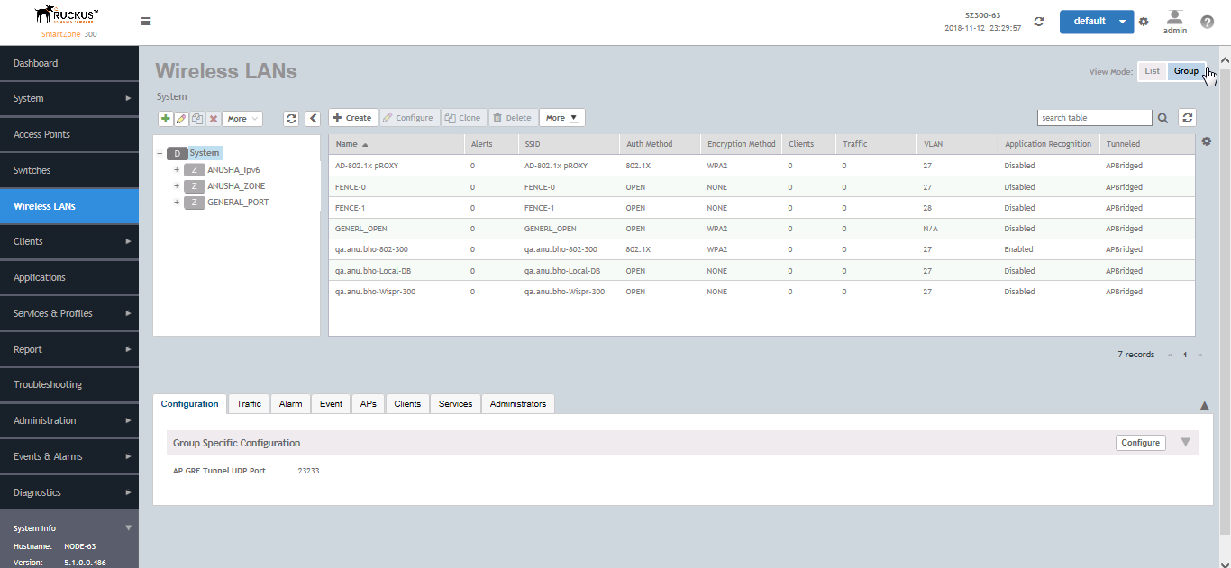

  1. In the Wireless LANs page, from the System tree hierarchy, select the Zone where you want to create a WLAN.
    Figure 110  Wireless LANs

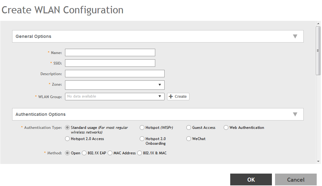

  2. Click Create and the Create WLAN Configuration page is displayed.
    Figure 111  Create WLAN Configuration
  3. Set the required configurations as explained in the following table.
