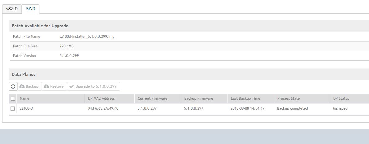

To Upgrade the Data Plane:
  1. Go to Administration > Upgrade.
  2. Select the DP Patch tab.
    The DP Patch page appears.
    Figure 241  DP Patch - Data Plane Upgrade
  3. In Patch File Upload, click Browse to select the patch file (.ximg file).
  4. Click Upload. The patch files is uploaded.
    The controller automatically identifies the Type of DP (vSZ-D or SZ-D) and switches to the specific Tab page. Uploads the file to its database, and then performs file verification. After the file is verified, the Patch for Pending Upgrade section is populated with information about the upgrade file.
    The following details are displayed:
    • Patch File Name: Displays the name of the patch file.
    • Patch File Size: Displays the size of the patch file.
    • Patch Version: Displays the version of the patch file.
  5. In Data Planes, identify the data plane you want to upgrade, and then choose a patch file version from Select upgrade version.
  6. Click Apply to apply the patch file version to the virtual data plane.
    The following information about the virtual data plane is displayed after the patch file upgrade is completed.
    • Name: Displays the name of the virtual data plane.
    • DP MAC Address: Displays the MAC IP address of the data plane.
    • Current Firmware: Displays the current version of the data plane that has been upgraded.
    • Backup Firmware: Displays the backup version of the data plane.
    • Last Backup Time: Displays the date and time of last backup.
    • Process State: Displays the completion state of the patch file upgrade for the virtual data plane.
    • DP Status: Displays the DP status.
You have successfully upgraded the virtual data plane.
To have a copy of the data plane firmware or move back to the older version, you can select the data plane from the list and click Backup or Restore respectively.
