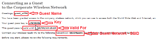

Figure 126  What a guest pass printout looks like
