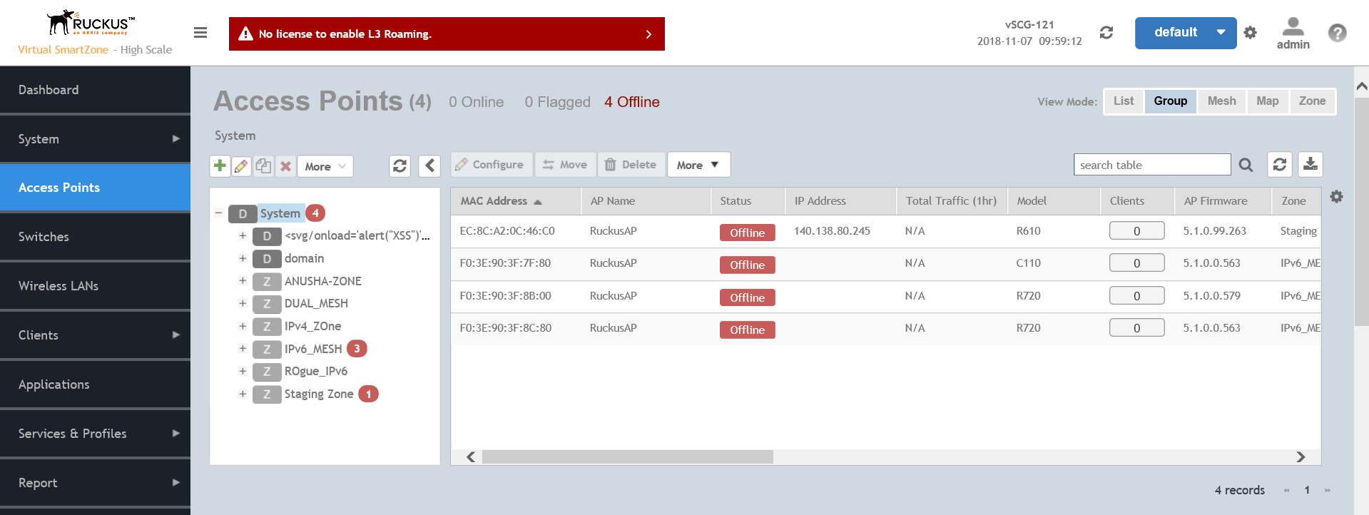

  1. On the menu, click Access Points.
    Figure 37  Access Points Page
  2. From the System tree hierarchy, select the location where you want to create the zone (for example, System or Domain), and click .
    Figure 38  Create Groups Page
