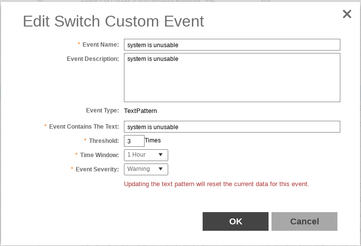

You can create custom events to define failure scenario and use them to generate troubleshoot switch issues.

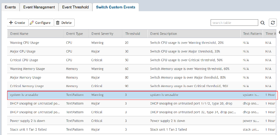

For example, you can create a "system is unusable" event with the following settings. Based on this event definition and configuration, if any switch sends this message thrice in one hour, the controller triggers a Custom Event. You can view the "system unavailable" event from the Switch Custom Events page. For more information on custom events, see Creating Custom Events for ICX Switches
Figure 102  Troubleshooting switch issues through custom events
