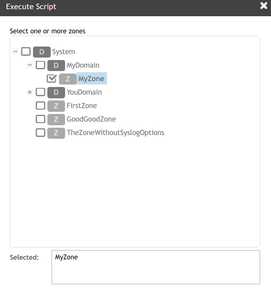

    Figure 240  Executing script
  6. Select one or more zones from the domain tree.
  7. Click OK to run the AP CLI script on the AP zone.
The controller runs the selected script on the specified zone.
