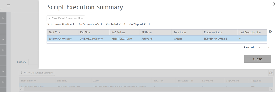

  6. To view the execution summary of a script, select a script from this list and click View Execution Summary.
    You will be able to view information such as the script name, number of execution attempts that were successful, failed and skipped, start and end time of the execution process, MAC address of the AP, AP and zone names, execution status and last line of the execution.
    Figure 243  Script execution summary
