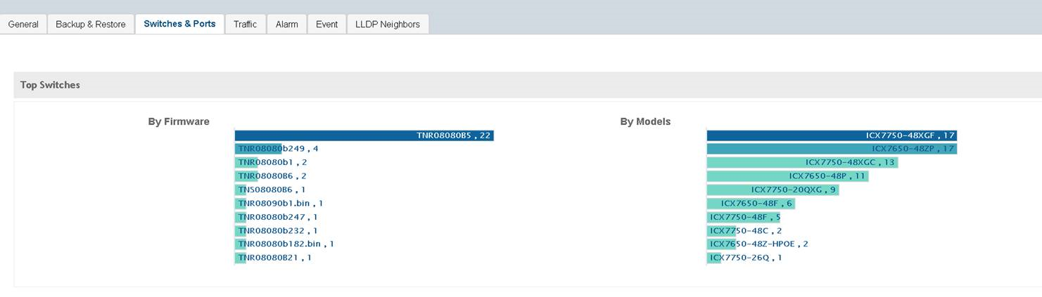

- Top Switches: provides a graphical representation of the top switches in the group based on their model and firmware.
NOTEThis is only applicable to switch groups, and hence shown only when a switch group is selected.Figure 54 Top Switches

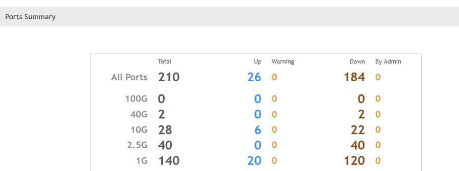

- Ports Summary: provides information about the ports of the selected switch or group. It displays the total number of ports connected to the switch or stack, number of ports active at various speeds (e.g. 1G, 10G),operational status of the ports (Up and Down), warnings associated with ports when alarms or events are raised and the number of ports managed by an administrator.
Figure 55 Port Summary

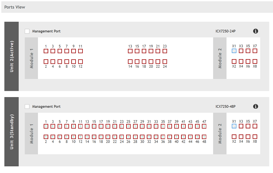

- Ports View: provides information about state of all the ports within each module of the switch such as Up, Down, Admin Down and so on.
Figure 56 Ports View

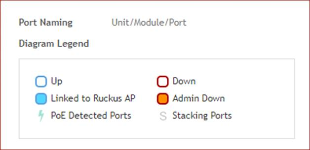

The figure indicates the meaning of the colors used in the Ports View.
Figure 57 Legend
The following list further describes items in the Ports View legend.- Up: indicates ports that are up or active
- Warning: indicates ports that have packet errors
- Down: indicates ports that are down or inactive
- By Admin: indicates ports that are manually disabled by the network administrator
