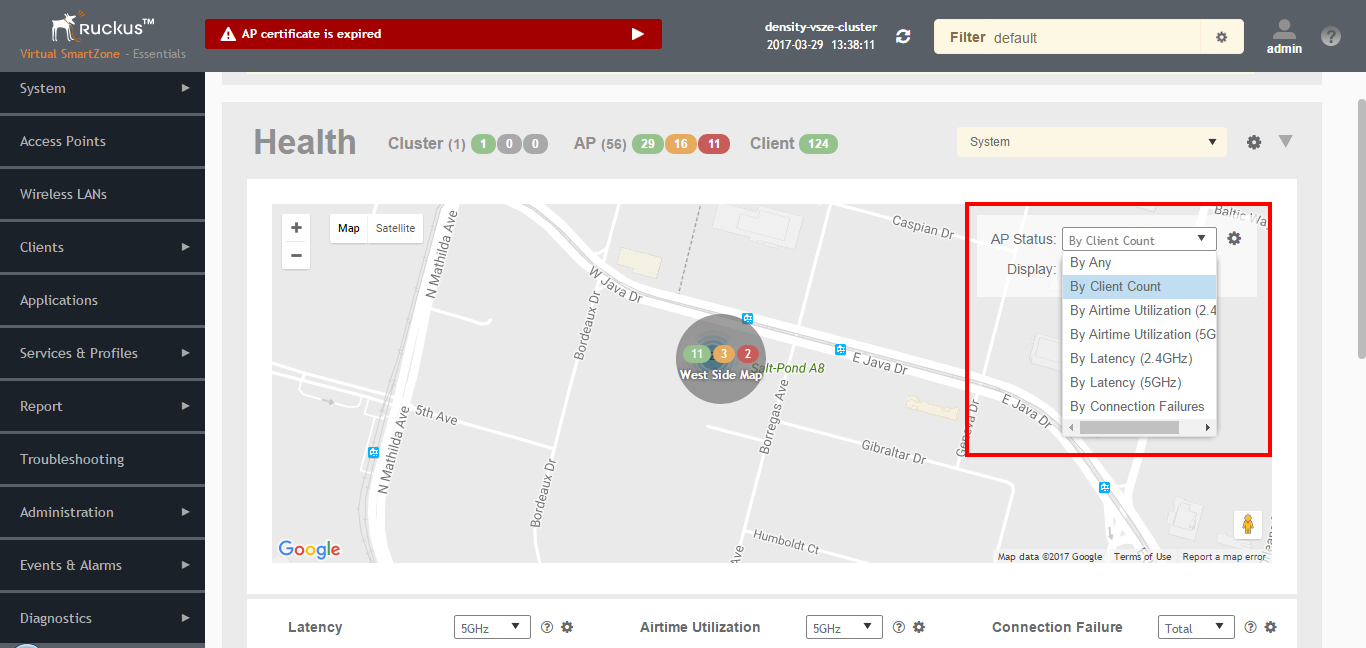

Use the Google Maps view just as you would normally use Google Maps - including zoom, satellite view, rotate and even street view icons. You can customize the AP icon information displayed on the map using the tools in the upper-right hand corner.

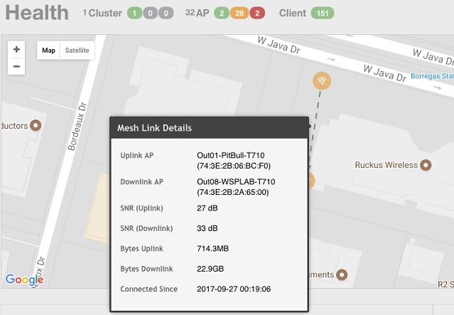

Use the Settings (gear) icon to configure the information displayed in tooltips when hovering over an AP on the map. You can also change the view mode altogether, from map view to Groups, Control Planes or Data Planes view mode using the settings menu. Additionally, you can also select the check-box to show mesh links. These links appear as dotted lines. If you hover over the mesh link on the map, a pop-up appears displaying more information such as the following:
  • Uplink AP: displays the IP address of the uplink AP to which the wireless client sends data
  • Downlink AP: displays the IP address of the downlink AP from which data is sent back to the wireless client
  • SNR (Uplink): displays the signal-to-noise ratio in the uplink path
  • SNR (Downlink): displays the signal-to-noise ratio in the downlink path
  • Bytes (Uplink): displays the bytes of data transferred from the client to the uplink AP
  • Bytes (Downlink): displays the bytes of data transferred from the downlink AP to the client
  • Connected Since: displays the date and time when the mesh connection was established
Bytes (Uplink) and Bytes (Downlink) are aggregate counters for the mesh connection since the start of that mesh connection. If the mesh link is broken and restarts, the counter restarts. If the mesh AP connects to a different mesh root or uplink, the counter restarts.
Figure 10  Mesh Link Details
You can also select the Google Map API key to use the Maps service with the application.
Figure 11  Configuring map settings
