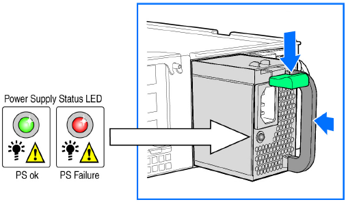

  1. Identify the faulty PSU by looking at the PSU status LED (red indicates PSU failure, green indicates normal operation).
  2. Press and hold the green safety lock downward while grasping the PSU handle.
  3. Pull outward on the handle, sliding the PSU all the way out of the rear of the machine.
  4. Insert the new PSU into the slot and, while holding the green safety lock, slide the PSU into the slot until it locks in place.
The PSU status LED turns green, indicating that the PSU is operating normally.

Figure 199  Replacing a PSU
