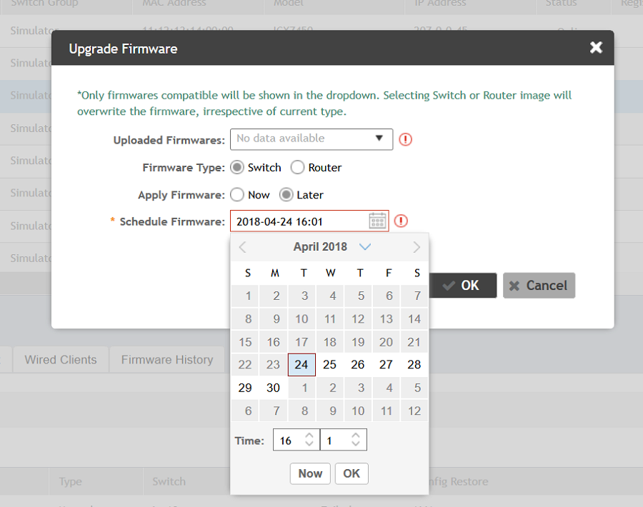

  2. From the ICX Switches page, select the switch that you want to upgrade and click More.
  3. From the drop-down menu, select Schedule Firmware.
    The Upgrade Firmware page appears.
    Figure 50  Scheduling Firmware Upgrade
  4. From Uploaded Firmware, select the firmware version that you want the switch to be upgraded to
  5. In Firmware Type, select type of firmware you want to upload to the switch. Options include Switch and Router images.
  6. In Apply Firmware, set when you want to apply the new firmware version to the switch. You can select Now or Later to schedule your upload. If you select Later, then you must select the date from the Schedule Firmware field.
  7. Click OK.
    If you want to delete the schedule you created; From More, click Deleted Firmware Schedule(s).
