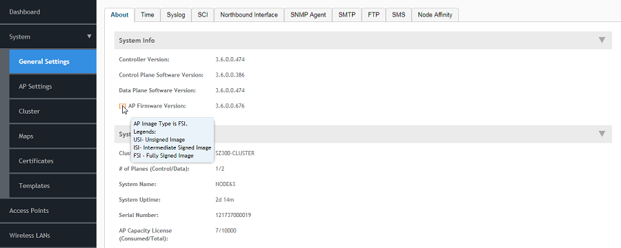

Viewing System Settings
You can view the system information such as the controller version, firmware version, license information, control and data plane details from the General Settings tab.
To view the system settings, from the left pane, select . The following system information is displayed:
- Controller Version
- Control Plane Software Version
- Data Plane Software Version
- AP Firmware Version (hover over the field to see the firmware type)
- Cluster Name
- Number of Planes
- System Name
- System Uptime
- Serial Number
- 3GPP Tunneling License
- AP Capacity License
- AP Direct Tunnel License
- Data Plane Capacity License
Figure 21
General Settings
