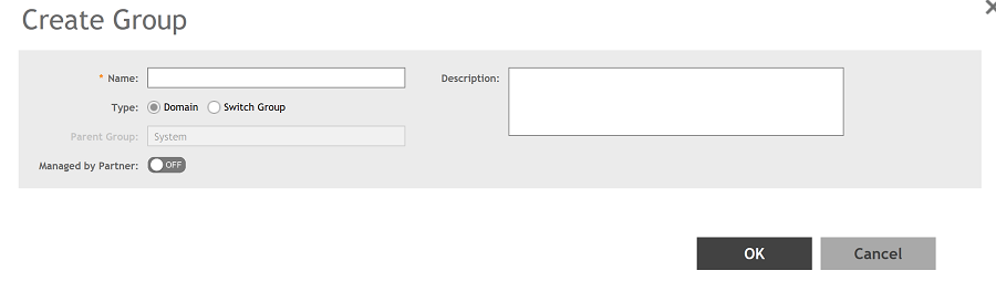

    The Create Group page appears.
    Figure 46  Creating switch groups
    Configure the following:
    • Name: type the name of the switch group that you want to create
    • Description: enter a brief description for the switch group
    • Type: select Switch Group. For enterprise devices such as SZ-300 and vSZ-H, you also have the option to select Domain.
    • Parent Group: displays the parent group under which the switch group resides
    • Managed by Partner: this option is available if you select the group type as Domain. You can slide the radio button to ON or OFF to enable or disable partners from managing the switches.
  3. Click OK. The switch group is created under the selected parent group.
