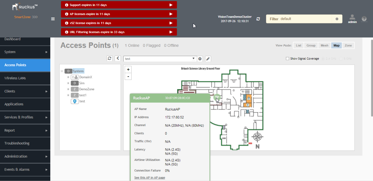

Use the Map view on the Access Points page to monitor APs in relation to your venue's floorplan.
- Go to Access Points.
- In View Mode, click the Map button. The map view is displayed with your placed APs.
Hover over an AP to view the following AP-specific details:

Figure 34 Hover over an AP to view details
- To view more specific details on the AP, click the See this AP in AP page link.
- To view the RF signal strength, select the Show Signal Coverage check box and choose the required RF frequency. For example, 2.4 GHz or 5 GHz. The heat map is displayed with a color-gradient legend. High signal strength appears in red. The color changes as the signal strength reduces.
