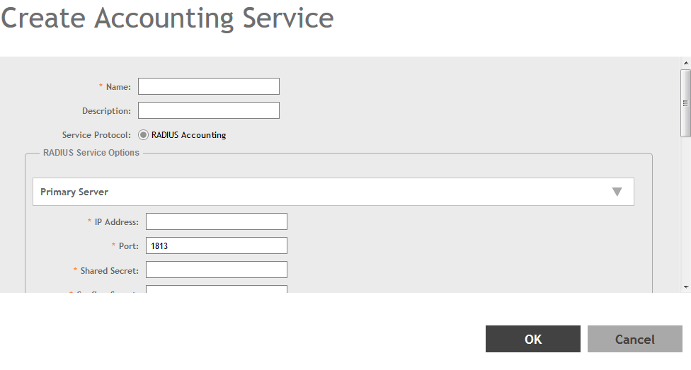

  1. Go to Services & Profiles > Accounting.
  2. Select the Proxy tab, and then select the zone for which you want to create the AAA server.
  3. Click Create.
    The Create Accounting Service page appears.
    Figure 125  Creating an Accounting Service
  4. Configure the following:
    1. Name: Type a name for the authentication service that you are adding.
    2. Description: Type a description for the authentication service.
    3. Service Protocol:
      • RADIUS Accounting. For more information, see the RADIUS Service Options.
  5. Click OK.
You have completed creating a Proxy Accounting AAA server.
