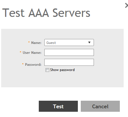

    The Test AAA Server page appears.
    Figure 123  Testing an AAA Server
  4. Configure the following:
    1. Name: Select one of the AAA servers that you previously created.
    2. User Name: Type an existing user name on the AAA server that you selected.
    3. Password: Type the password for the user name you specified.
  5. Click Test.
