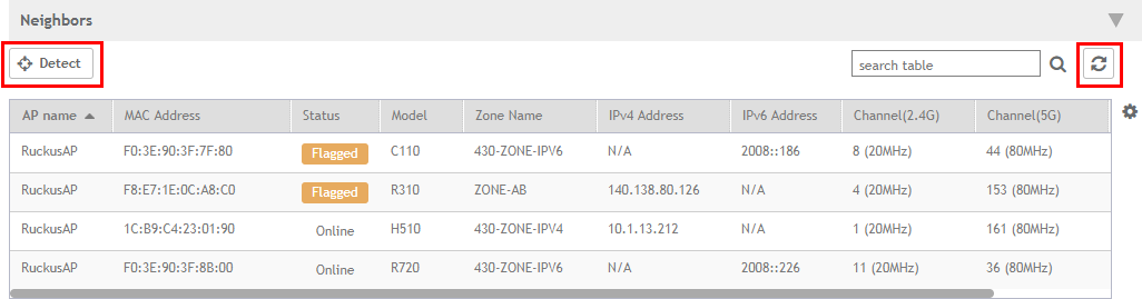

  1. From the Access Points page, select an AP from the list which is not assigned to a Staging Zone.
  2. Scroll down to the bottom of the page, select the General tab. In the Neighbors area, click Detect. The list of neighboring APs are displayed in the table.
    Figure 36  Neighbor APs for a Non-Mesh Zone
  3. To refresh the list, click the Refresh button.
