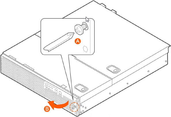

- Loosen the captive bezel retention screw on the right side of the bezel (see A in Figure 154).
- Rotate the bezel to the left to free it from the pins on the front panel (see B in
Figure 154), and then remove
it.Figure 154 Removing the front bezel
