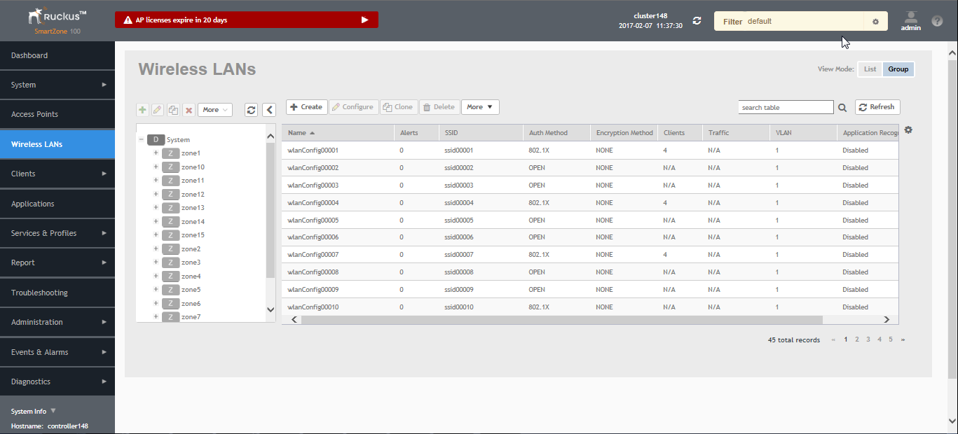

Creating a WLAN Configuration
To create a WLAN configuration:
