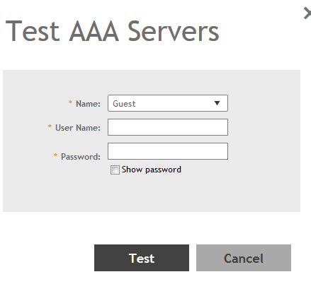

			  Test AAA Server page appears.
			  Figure 154
             Testing an AAA Server
		  Configure the following:
				- Name: Select one of the AAA servers that you previously created.
- User Name: Type an existing user name on the AAA server that you selected.
-  Password: Type the password for the user name you specified.
		  Click
			 Test.
		   If the controller was able to connect to the authentication server and retrieve the configured groups/attributes, the information appears at the bottom of the page. If the test was unsuccessful, there are two possible results (other than success) that will be displayed to inform you if you have entered information incorrectly:
			 Admin invalid
			  or
			 User name or password invalid. These results can be used to troubleshoot the reasons for failure to authenticate administrators with an AAA server through the controller.
