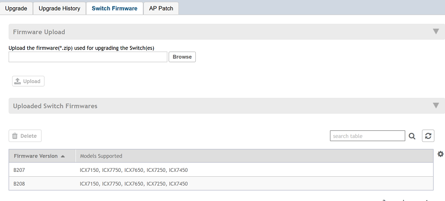

You can upload the latest available firmware to a switch from the controller, thereby upgrading the firmware version of the switch.
Select
Select the
Switch Firmware tab.
Figure 210
Upgrading the Switch Firmware
In Firmware Upload click
Browse to select the firmware file for upgrading the switch.
Click
Open.
Click
Upload. The upload status bar is displayed, and after the firmware file is uploaded, the
Uploaded Switch Firmwares section is populated with the firmware version and switch models it supports.
You have successfully uploaded the switch firmware to the controller.
