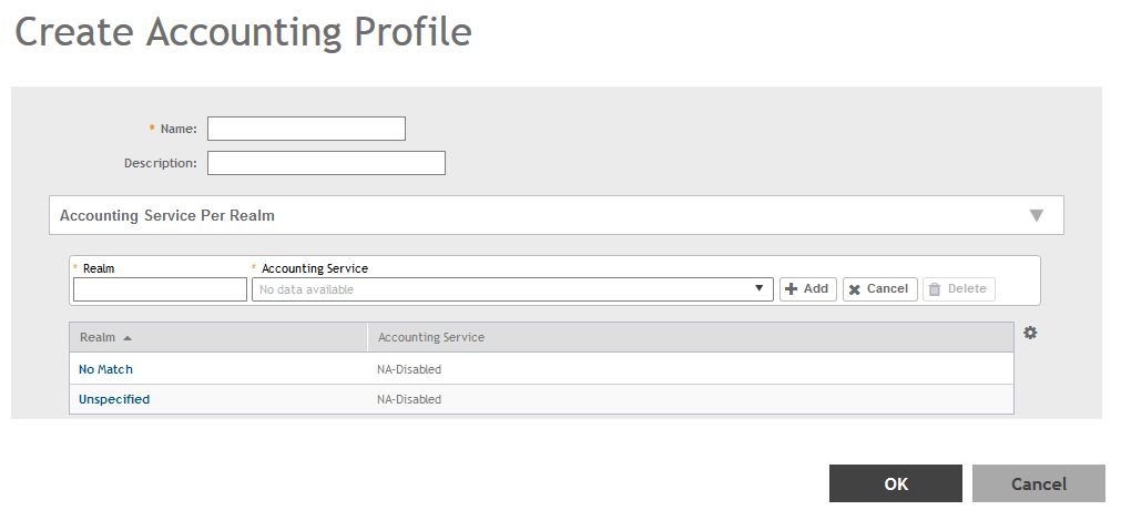

An accounting profile defines the accounting
    policy when the controller is used as a RADIUS proxy for WLAN services.
        Go to .
        Select the Realm Based Proxy tab, and
          then select the zone for which you want to create the AAA server.
        Click Create.
         The  Create Accounting Profile page appears. Figure 158
             Creating an Accounting Profile
        Configure the following:
            - Name: Type a name for the authentication service that you are adding.
- Description: Type a description for the authentication service.
- Accounting Service per Realm: Specify the accounting service for each of the realms
              specified in this table. If you set the accounting service for a particular realm to
              NA-Disabled, then the accounting request is rejected. To create a new service click,
                Create and then configure Realm and
                Accounting Service.
        Click OK.
You have completed creating a Realm-based proxy Accounting AAA server.
