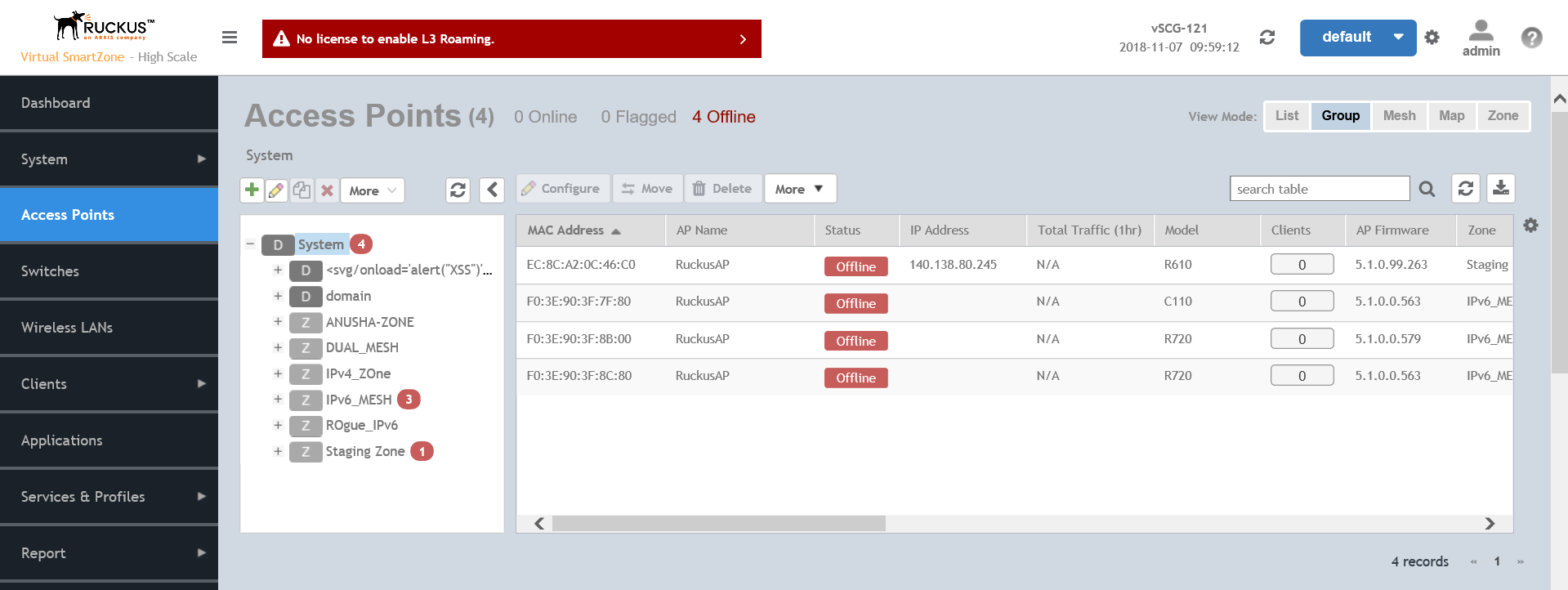

To create an AP zone
  1. On the menu, click Access Points. The figure below appears.
    Figure 36  Access Points
  2. From the System tree, select the location where you want to create the zone (for example, System or Domain), and then click .
    Figure 37  Create Groups
