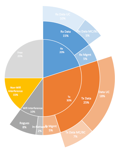

  • Airtime Utilization - Percent of airtime utilized, by radio. Clicking Airtime Detail displays a pie chart that depicts a detailed breakup of the reception and transmission percentages (Rx and Tx) against parameters such as Data, Management, Unicast, Multicast, Interference and Network Load. Following are the statistics that are evaluated:

    Total Total Airtime under observation
    RxLoad Airtime spent in receiving frames destined to AP in Micro seconds
    RxInt Airtime spent in receiving frames NOT destined to AP in Micro seconds
    TxSuccess Airtime spent in transmitting frames successfully in Micro seconds
    TxFailed Airtime spent in transmit failed in Micro seconds
    NonWifi Airtime where CCA is busy in Micro seconds
    RxTotal Same as RxLoad or sum of Rx (Mgmt Unicast + Mgmt Bcast + Data Unicast + Data Bcast)
    RxMgmtU Airtime spent in receiving Management Unicast frames in Micro seconds
    RxMgmtB Airtime spent in receiving Management Broadcast frames in Micro seconds
    RxDataU Airtime spent in receiving Data Unicast frames in Micro seconds
    RxDataB Airtime spent in receiving Data Broadcast frames in Micro seconds
    TxTotal Same as TxSuccess or sum of Tx (Mgmt Unicast + Mgmt Bcast + Data Unicast + Data Bcast)
    TxMgmtU Airtime spent in transmitting Management Unicast frames in Micro seconds
    TxMgmtB Airtime spent in transmitting Management Broadcast frames in Micro seconds
    Figure 17  Sample Airtime Utilization Pie Chart
