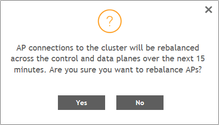

To rebalance APs across the nodes:
- Go to System > Cluster > Control Planes > More >
Rebalance APs. Figure 52 AP Rebalancing Form
- Click Yes, the controller rebalances AP connections across the nodes over the
next 15 minutes.NOTEIf you want to repeat this procedure, you must wait 30 minutes before the controller will allow you to rebalance APs again.
