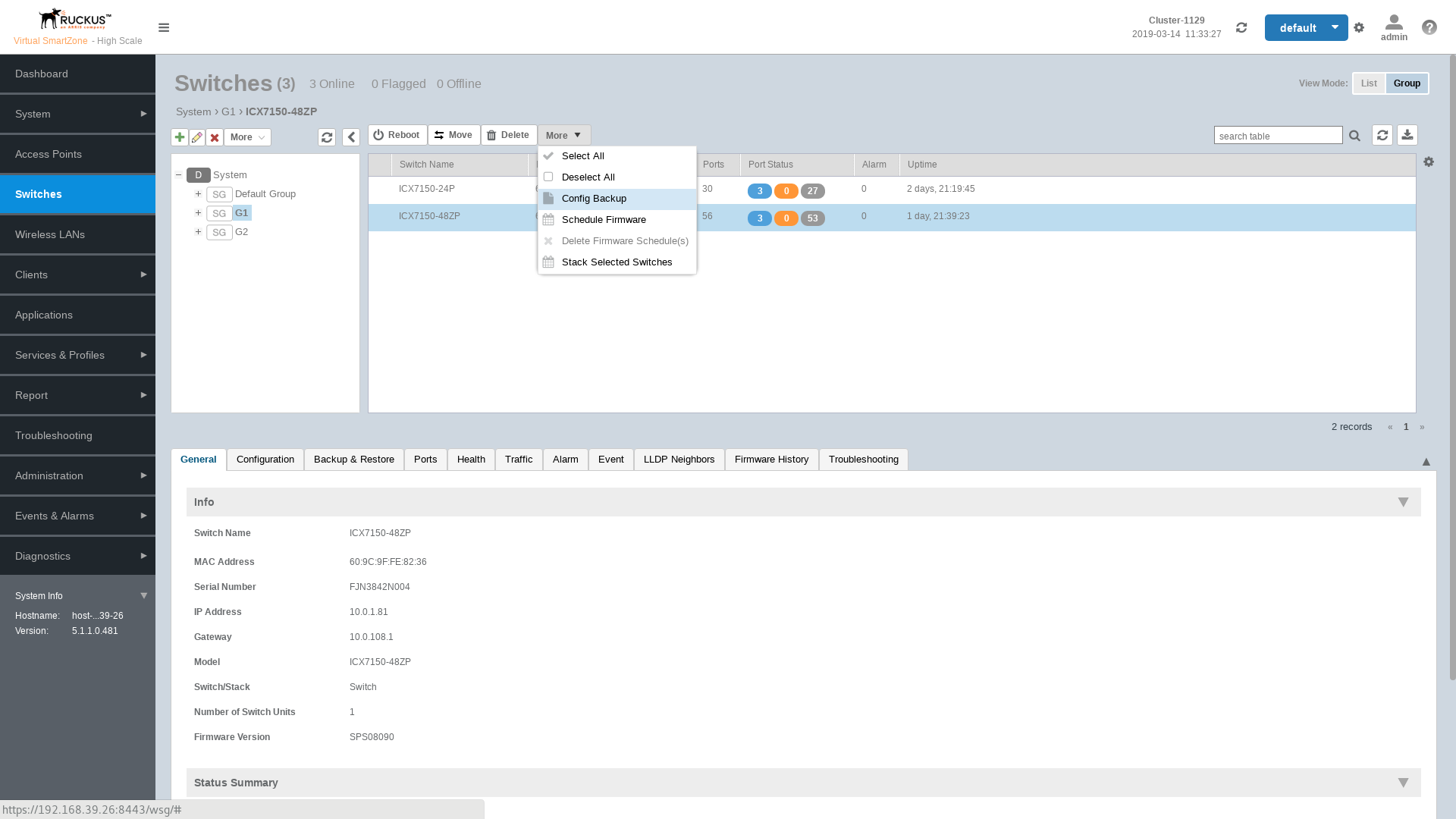

Backing up and Restoring ICX Switch Configuration
SmartZone can back up the switch's running configuration. By default, SmartZone makes a backup of switch configuration on a daily basis. The configuration is only stored if there is a change between the last configuration backup and the current backup. Otherwise, it is discarded. SmartZone saves the last seven configuration backups. When needed, these backups can be restored to the switch. While performing network maintenance, you can initiate a backup without having to wait for the daily backup.
Perform the following steps to configure ICX switch backups.
Be sure to sync the controller to the NTP server during installation. You can also do this from
