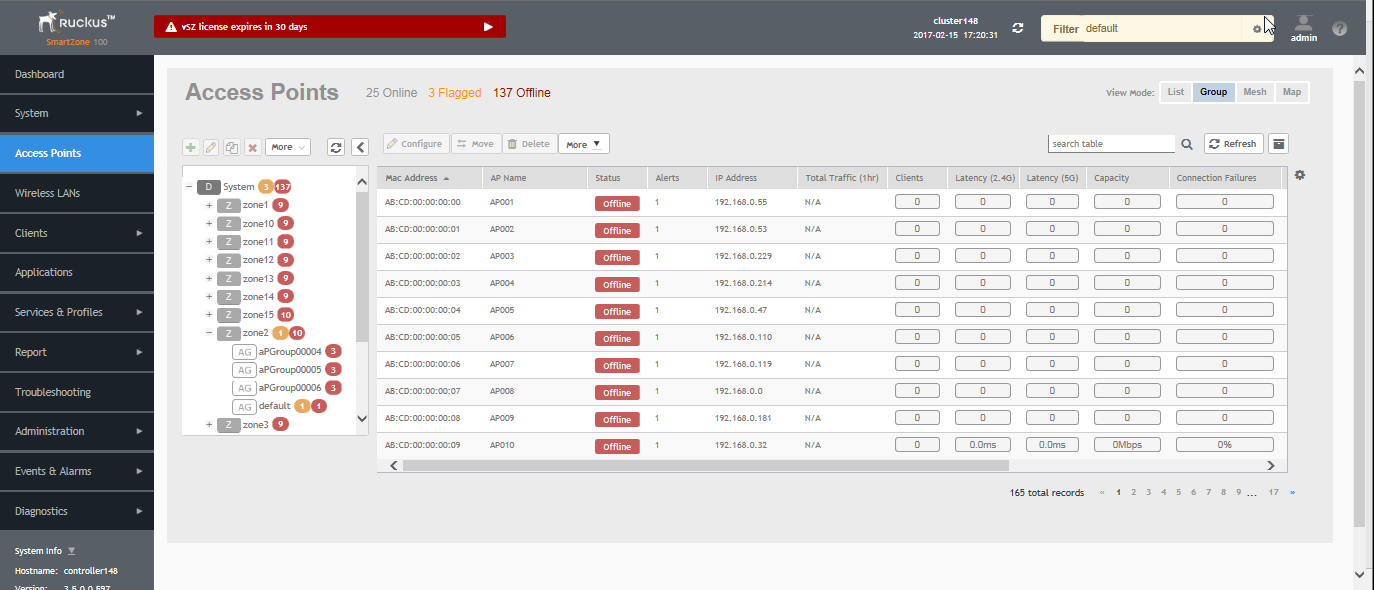

  1. From the left pane, select Access Points. The below figure appears.
    Figure 38  Access Point

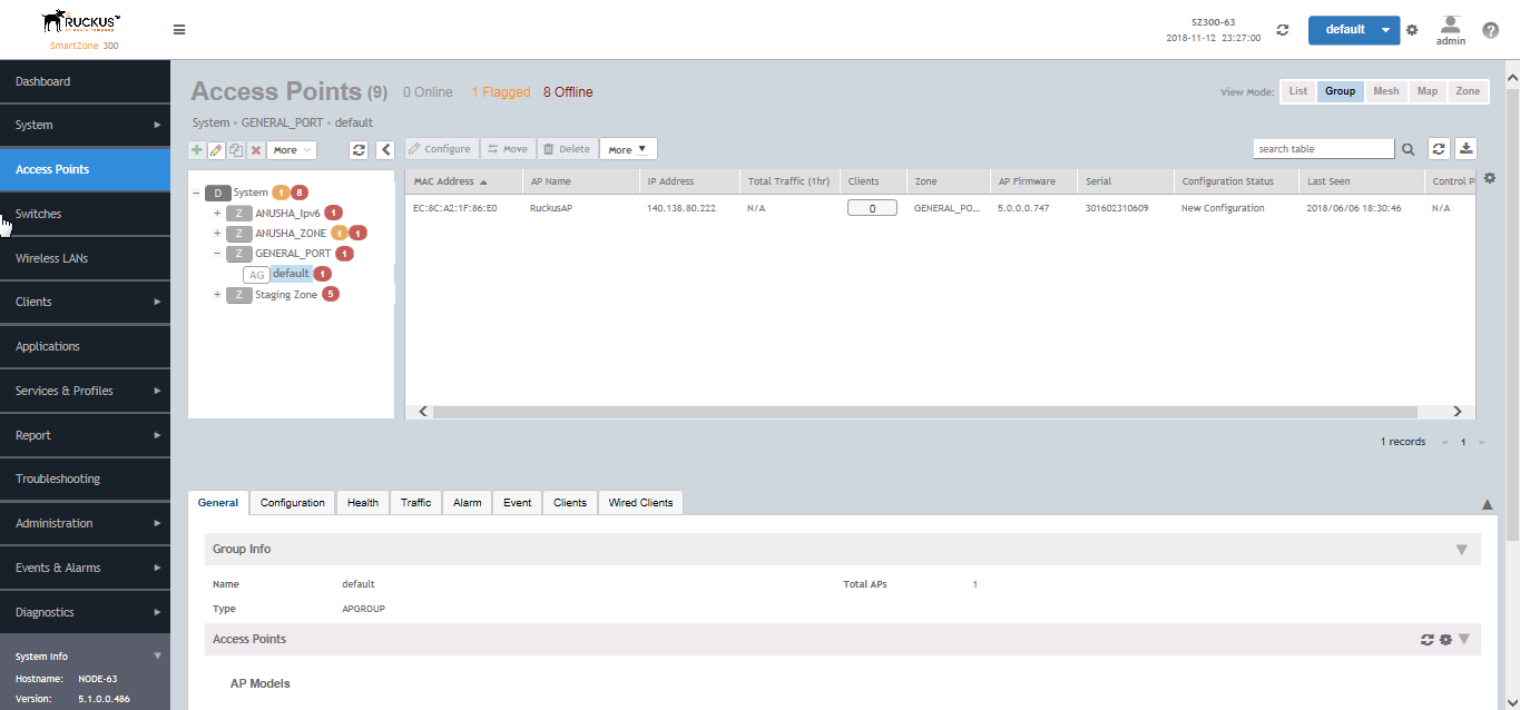

  2. From the System tree hierarchy, select the location (for example: System, Domain, Zone) and click . The following figure appears.
    Figure 39  Create Groups
  3. Enter the details as explained in the following table.
    You can also edit the configuration of default APs by selecting the AP and clicking the icon.
  4. Click OK.
