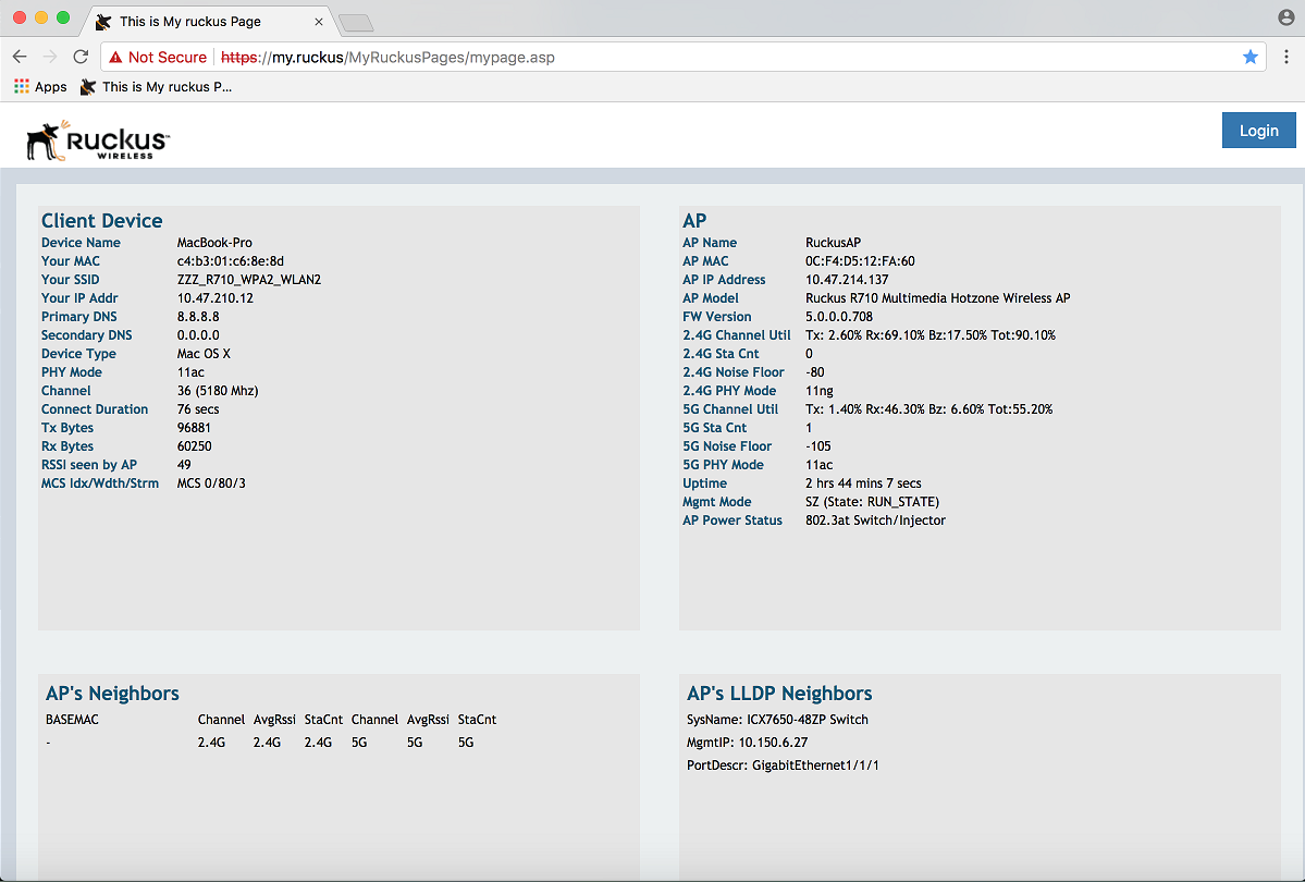

When connected to an authenticated WLAN, you can enter
https://my.ruckus on a web browser and view the following diagnostic information:
- Client Device
- AP
- AP's Neighbors (Wireless)
- AP's LLDP Neighbors (Wired)
Figure 245
Viewing Diagnostic Information in WPA2 WLAN

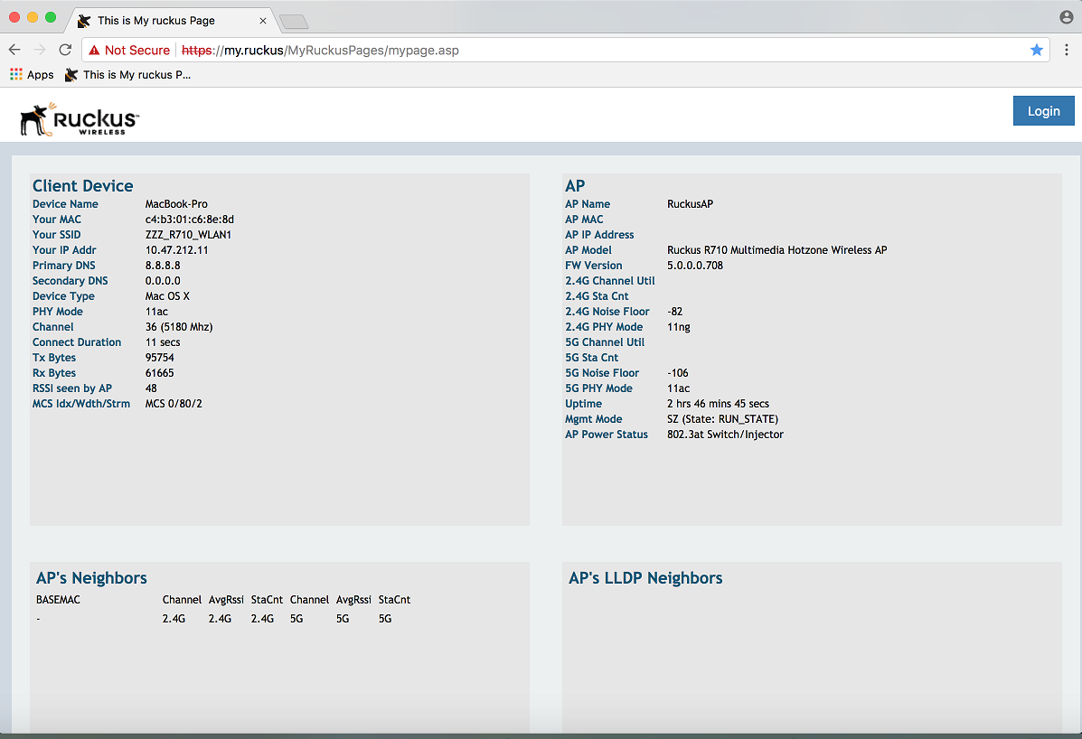

On entering
https://my.ruckus when connected over an Open or WEP WLAN, the diagnostic information is restricted for security reasons.
Figure 246
Viewing Diagnostic Information in Open WLAN
