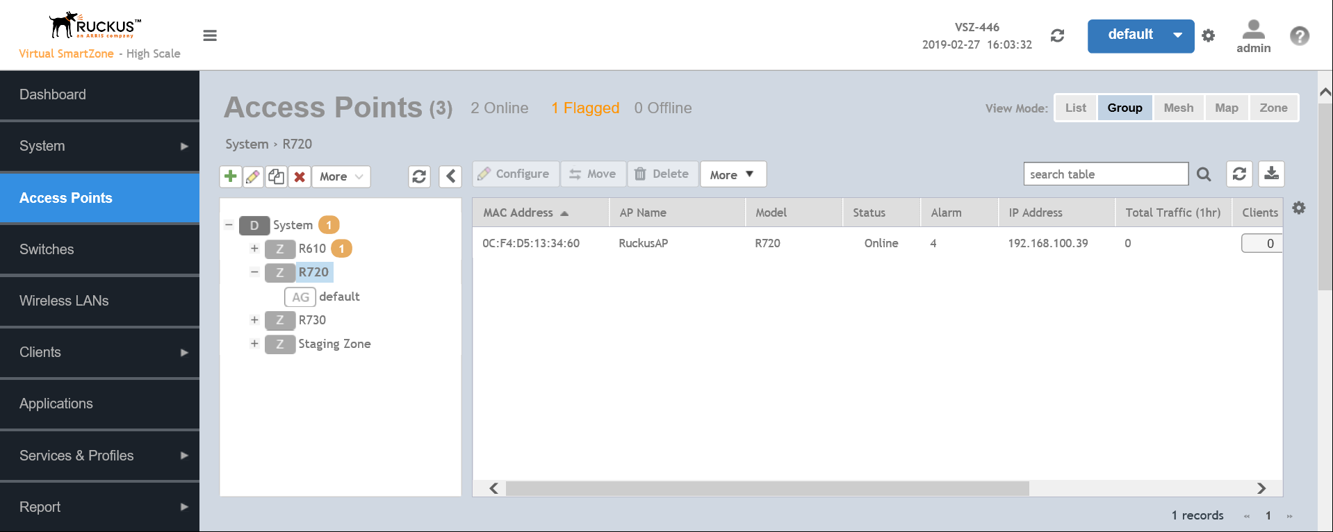

  1. From the left panes, click Access Points. The Access Points page is displayed.
    Figure 47  Viewing the Access Points

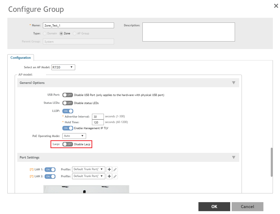

  2. Select a zone and click . The Configure Group page is displayed.
    Figure 48  Enabling LACP Support for a Zone
  3. Enter the zone name.
  4. Under Configuration, select R720 from the Select an AP Model list.
  5. Under General Options, enable LACP.
    By default, LACP is disabled.
    To support the LACP and LAG feature on Ruckus APs, ensure that the correct PoE mode is selected to bring up LAN1,2 ports. For example, PoE-at+ for R720, PoE-at for R710. The LACP and LAG UL throughput is limited to around 1Gbps.
