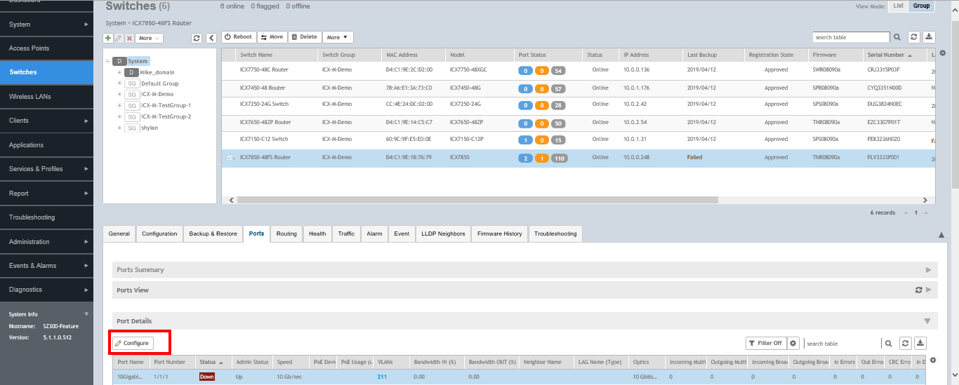

Complete the following steps to display information on ports for a switch, stack, or switch group.
    The ICX Switches page is displayed.
  2. Select the switch group and click the Ports tab.
    The Switch Port page is displayed.
    Figure 80  Switch Port Page
  3. Under Port Details, select the port that must be updated and click Configure. The Port Settings page is displayed.

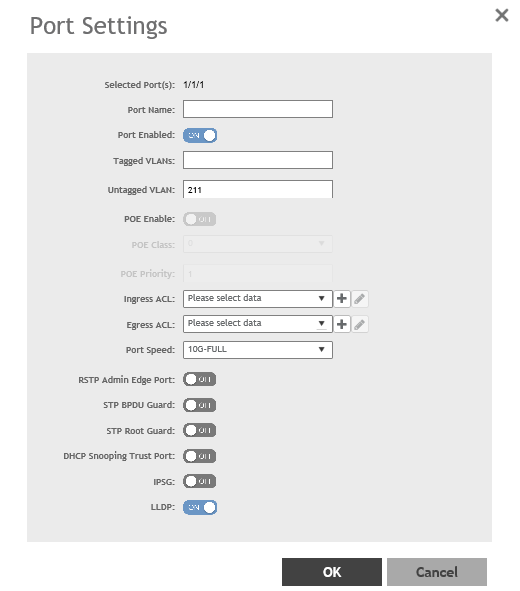

    Figure 81  Port Settings Page
  4. Configure the following port settings:
    • Port Name: Enter the port name.
    • Port Enabled: Click to enable the option.
    • Tagged VLANs: Enter the tagged VLAN ID or VLAN range.
    • Untagged VLAN: Enter an untagged VLAN ID.
    • POE Enable: Click to enable the option.
    • POE Class: ​ Enter the PoE class.
    • POE Priority: Enter the PoE priority.
    • Ingress ACL: Select the ingress ACL from the list.
    • Egress ACL: Select the egress ACL from the list.
    • Port Speed: Select the required port speed from the list.
    • RSTP Admin Edge Port: Click to enable the option.
    • STP BPDU Guard: Click to enable the option.
    • STP Root Guard: Click to enable the option.
    • DHCP Snooping Trust Port: Click to enable the option.
    • IPSG: Click to enable the option.
    • ILLDP: Click to enable the option.
  5. Click OK.
