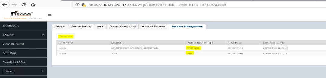

From the Session Management tab, you can view and also terminate the administrator's sessions that are currently sunning.
  1. From the controller web interface, go to Administration > Admin and Roles > Session Management
  2. Select the administrator session you want to discontinue and click Terminate.
    The Password Confirmation page appears.
  3. Type the password and click OK. The session ends.

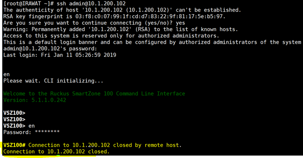

    You can terminate all CLI and UI sessions that you were logged into.
    Figure 237  Sample Session Termination for UI session.
    Figure 238  Sample Session Termination for CLI session.
