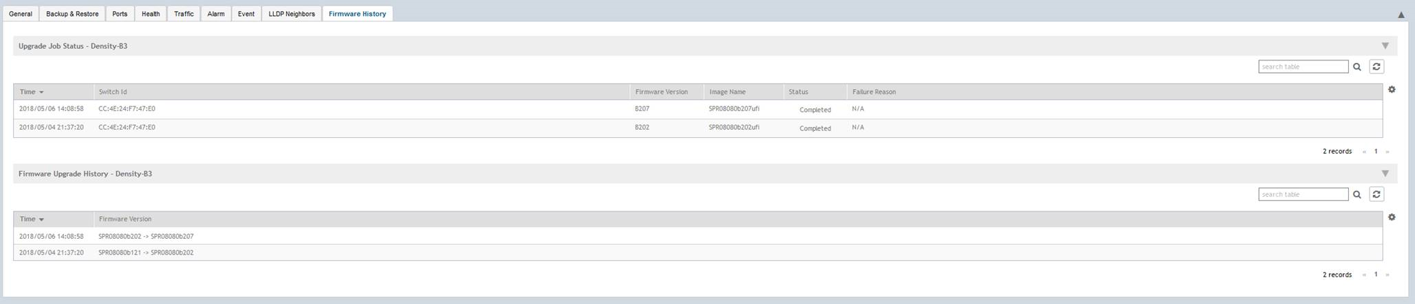

  2. Select the switch or group. Then select the Firmware History tab.
    The Firmware History tab is displayed.
    Figure 100  Viewing Firmware History
    You can verify the status of the upgrade from the Upgrade Job Status section which displays the time, switch ID, firmware version, image name, status and failure reasons (if any) for the upgrade.
    The Firmware Upgrade History section displays the time of the pervious upgrade operations, and firmware versions to which the upgrade was done.
