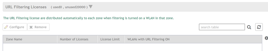

    The URL Filtering Licenses page displays the following:
    Figure 236  URL Filtering Licenses
    • Zone Name: name of the zone within which APs are present
    • Number of Licenses: displays the total licenses allocated to the zone
    • License Limit: can be set to a value or can be Unlimited. This displays the number of APs (with URL filtering enabled) that can be accommodated within the zone.
    • WLANs with URL Filtering ON: displays all the WLANs within the zone that have the URL filtering service enabled
