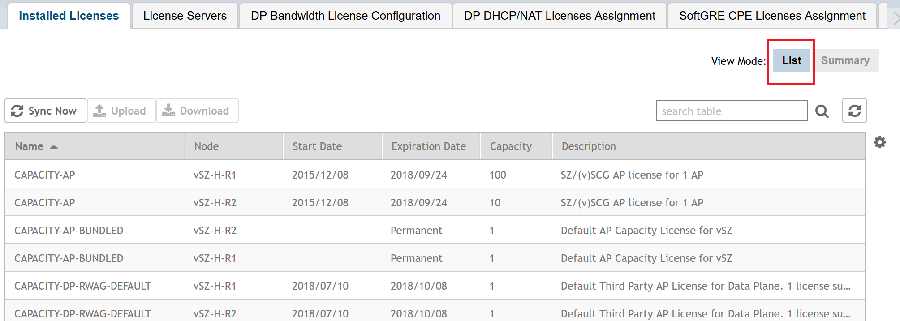

    The List view is displayed as shown in the following example.
  3. Select List as the View Mode.
    The license List view is displayed as shown in the following example.
    Figure 233  License List View
    In the List view, the following information is displayed for licenses that have been uploaded to the controller:
    • Name: The name of the node to which the license was uploaded
    • Node: The name of the controller node
    • Start Date: The date when the license file was activated
    • Expiration Date: For time-bound licenses, the date when the license file expires
    • Capacity: The number of units or license seats that the license file provides
    • Description: The type of license

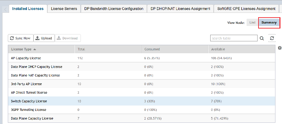

  4. Select Summary as the View Mode.
    In the Summary view, the information shown in the following example is displayed for the licenses that have been uploaded to the controller.
    • License Type: The type of license uploaded
    • Total: The total licenses (both consumed and available)
    • Consumed: The number of licenses consumed
    • Available: The licenses available
