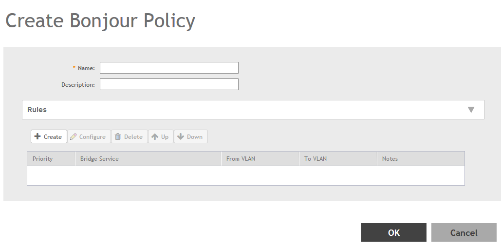

    The Create Bonjour Policy page appears.
    Figure 126  Creating a Bonjour Gateway Policy
  4. Configure the following:
    1. Name: Type a name for the policy.
    2. Description: Type a description for the policy.
    3. Rules: Create the policy rule by configuring the following
      1. Click Create. The Create Bonjour Policy Rule page appears.
      2. Configure the following options:
        • Bridge Service: Select the Bonjour service from the list.
        • From VLAN: Select the VLAN from which the Bonjour service will be advertised.
        • To VLAN: Select the VLAN to which the service should be made available.
        • Notes: Add optional notes for this rule.
      3. Click OK.
        You have created a Bonjour policy rule.
    4. Click OK.
You have created a Bonjour policy with a rule.
