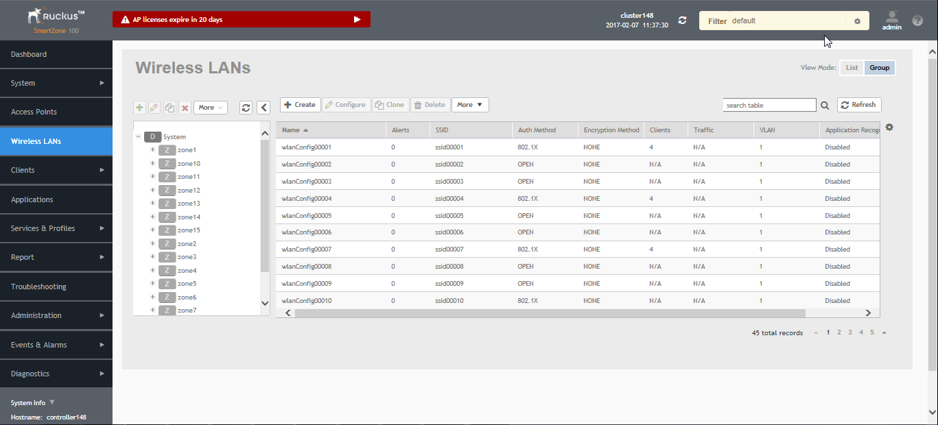

Creating a WLAN Configuration
To create a WLAN configuration:
Specifies the server used for
authentication on this network.
  1. In the Wireless LANs page, as shown in the figure below, from the System tree hierarchy, select the Zone where you want to create a WLAN.
    Figure 65  Wireless LANs

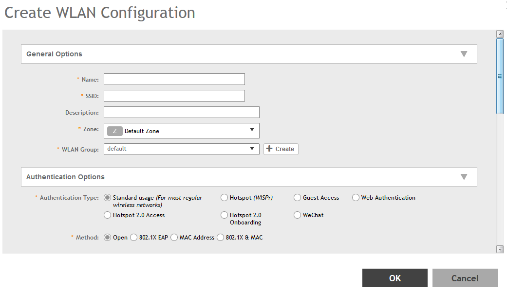

  2. Click Create. The below appears.
    Figure 66  Create WLAN Configuration
  3. Set the required configurations as explained in the table below.
  4. Click OK.
