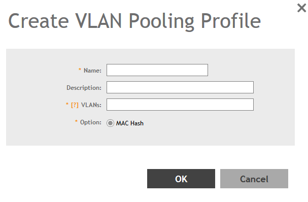

Creating a VLAN Pooling Profile
Each VLAN pool can contain up to 16 VLANs, and a maximum of 64 VLAN pools can be created. Each WLAN can be configured with a single VLAN pool.
  2. Select the VLAN Pooling tab, and then select the zone for which you want to create the profile.
  3. Click Create.
    The Create VLAN Pooling page appears.
    Figure 104  Creating a VLAN Pooling Profile
  4. Configure the following:
    1. Name: Type a name for the VLAN profile.
    2. Description: Type a short description for this profile.
    3. VLANS: Type the VLAN IDs to be assigned to this pool. VLAN IDs can be separated by hyphens, commas, or a combination (for example, 7-10, 13, 17, 20-28).
    4. Click OK.
You have created the VLAN Pooling profile.
