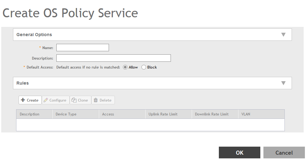

    The Create OS Policy Service page appears.
    Figure 102  Creating an OS Policy Service
  4. Configure the following:
    1. Name: Type a name for the OS policy.
    2. Description: Type a short description for this OS policy.
    3. Default Access: select either Allow or Block. This is the default action that the system will take if no rules are matched.
    4. Rules: Define the OS Policy rules. For more information see, Creating OS Policy Rules
    5. Click OK.
You have created the OS policy service.
