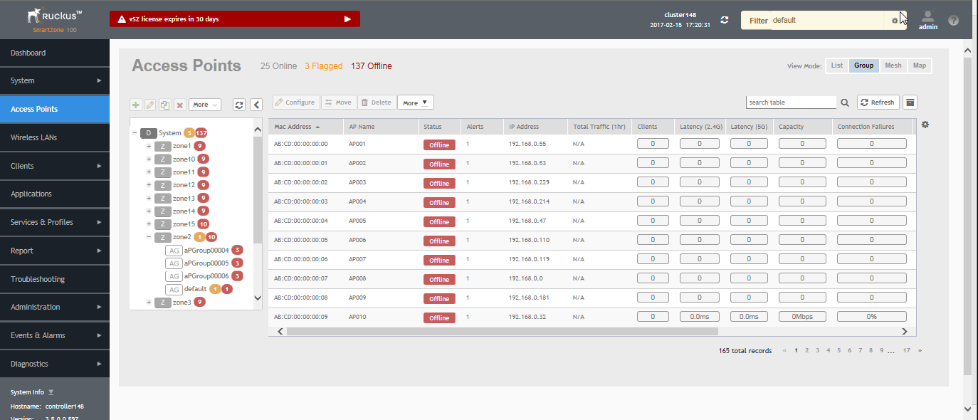

- From the left pane, select
Access Points. The below figure appears.
Figure 36 Access Point
- From the System tree hierarchy, select the location (for example: System, Zone) and click
. The following figure appears.
